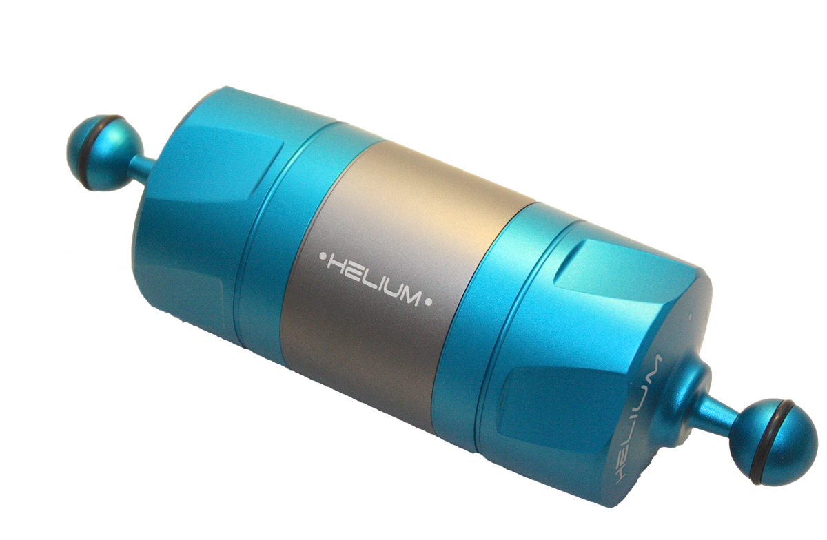

I just ordered a set of these:
Ultramaxdive
No image preview
HELIUM Variable Buoyancy Arm System
Innovative design HELIUM VBA (Variable Buoyancy Arm) System from ULTRAMAX allows you to create your BuoyFloat Arm’s lifting force from 0.5 lb (227g)~1.0 lb (453 g) using modular segments design to fit
My instructor has a set and seems to like them for travel as they break down (he also uses Ultralight style arms and Stixx floats). They have the added benefit of being a waterproof stash for keys, etc. They are about the same price as arms+floats, but seem to be less than the Nauticam carbon fiber float arms (they supposedly don't leak, or at least are less likely to fail than the Aliexpress variety).
