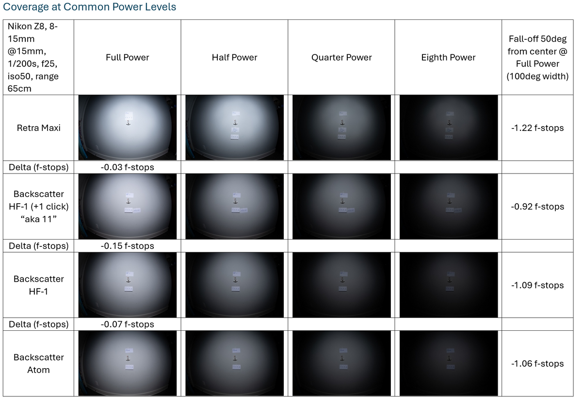

Continuation of the Pre-Review of the Retra Maxi Strobe....

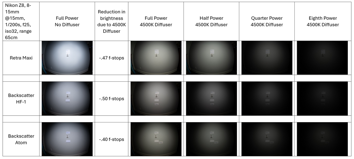

Studio Comparison Shots with Retra Maxi, Backscatter HF-1, and Atom Strobes
The following grid of images are comparison shots from Retra Maxi, Backscatter HF-1, and Backscatter Atom. This trio of strobes have a lot in common with a set of similar specifications.
These specs include:
  • High power, Wide Angle capable
  • Lithium Ion powered, two cells per strobe
  • Rapid recycling times
  • $800-1300 USD price range
For this comparison each strobe was set to Full power, Half power, Quarter power, Eighth power. The images were taken with a Nikon Z8, 8-15mm lens at 15mm, 140mm dome, at a range of 65cm from the wall. No filters or diffusers were used. The color temperature of all three strobes is similar at 6200k (Maxi), 6500k (HF-1), and 6400k (Atom). Aperture and ISO were f25 & iso50.
Unfortunately, it’s not an exact apples-to-apples comparison. The Retra does not have precise gradations at these power levels. It uses a 17-level scale from -4 to +4 “units” in .5-unit increments. The units don’t equate to F-stops exactly, but Retra reports the +3 and +2 are close to Half and Quarter power, so I went with that approximation.
The HF-1 does have a Full setting with Half, Quarter, and Eighth levels, but it also has two higher “Boost Levels” beyond F on the power dial. I found that the “F+1” or “11” setting was very close to the Retra Maxi at Full Power.
The Maxi also has single 30% boost level, but it is hidden behind a 3 second press of a button and then active for exactly 5 shots. I suspect this will rarely get used due to poor discoverability. (Does anyone ever read the manual?)
The Atom keeps it simple with clearly demarked power levels from 1/32 to Full. Additional even lower power levels of 1/64 to 1/1024 are available under a Low Power Mode accessible via the Mode button.
Power Level Test Suite
Findings: The Retra Maxi is a little brighter at each level. Partially this is due to the variance of the power level scales. One-click higher on the HF-1 evens it up with the Maxi. Since this HF-1 has those two additional clicks beyond Full, this is easily achieved.  I included an extra comparison row with the HF-1 turned to 11. (Full power plus one more click)
Backscatter advertises that the Atom at Full is equivalent to the HF-1 at Full, and the comparison shots support this claim. The HF-1 does have it’s +1 & +2 modes, so there is more headroom on the bigger strobe vs the Atom.
The Maxi is the brightest at Full, but I don’t think anyone is going to be lacking power with any of these strobes.
Summary Notes:
  • The HF-1 at Full +1 click is very similar to the Maxi, just a .03 f-stop delta.
  • The fall-off of light is similar across all three strobes at around 1 f-stop 50 degrees from center.
  • The Maxi has the greatest fall off at 1.22 f-stop reduction from center. The HF-1 @ 11 has the least at 0.92 f-stop reduction.
  • The HF-1 and Atom are remarkably similar, as advertised. The HF-1 is 0.07 f-stops brighter than the Atom at full power.
Edited by Dave_Hicks
Fixed bullet list formatting
  • Author
Coverage at Common Power Levels (Diffuser 4500k)
Summary Notes:
  • All three of these strobes are probably best configured with a warming filter due to their very cold outputs of 6400-6500 kelvin.
  • The diffuser for the Retra Maxi is their Wide-Angle Dome Diffuser delivering a 4500K output. Retra does not offer a flat diffuser.
  • The Backscatter HF-1 and Atom strobes were tested with their respective 4500K flat diffusers.
  • The fall off in power from Full was around 0.50 f-stops for all three strobes.
  • The Atom had the least reduction at 0.40 f-stops, and the HF-1 had the most at 0.50 f-stops.

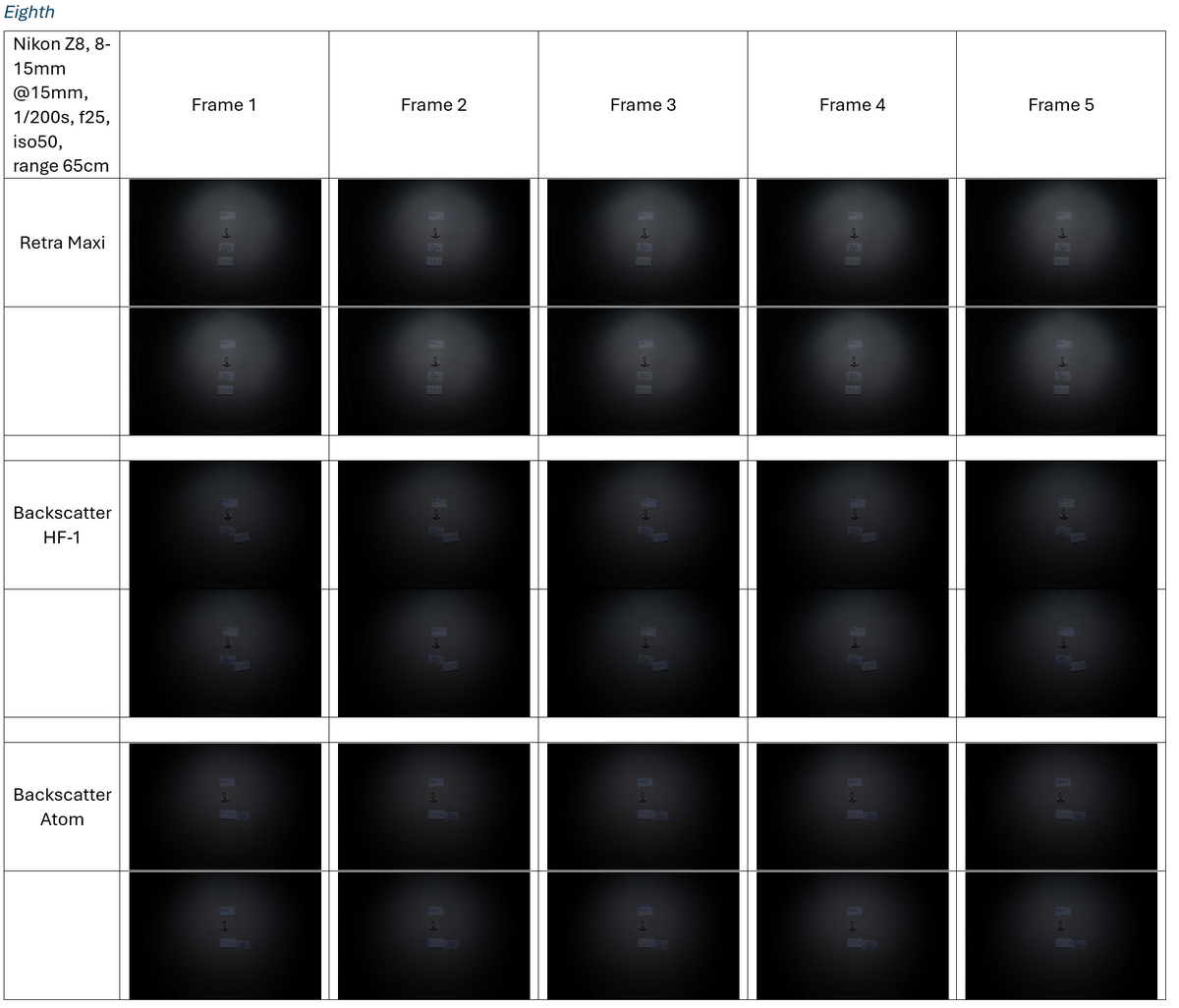

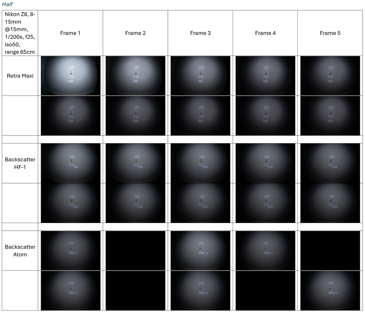

Burst Shooting Results at Common Power Levels
(10 frames at 3 frames per second)
Summary Notes:
  • The Retra Maxi clearly has a design priority of delivering a flash with every frame shot, even if that flash is severely under powered.
  • The Backscatter HF-1 and Atom have a different design priority where they attempt to flash only if they are close to the requested power level, resulting in black frames while the capacitor recharges.
  • Both designs have their own valid logic, and reasonable photographer might prefer one over the other.
  • The Retra Maxi will only deliver properly exposed frames at the start of the burst using Full or Half power. Subsequent shots will be very underexposed and may not be usable.
  • The Retra Maxi delivered just 1 fully exposed frame in a 10-shot burst at Full Power.
  • The Backscatter HF-1 delivered 5 fully exposed frames across the full span of the 10-shot burst at Full Power.
  • The Backscatter Atom delivered 3 fully exposed frames across the full span of the 10-shot burst at Full Power.
  • At Half Power the Maxi and HF-1 both delivered usable exposures across 10 shots, with the HF-1 being more consistent.
  • At Quarter Power all three strobes delivered the expected exposures across the full 10 shot burst.
  • Realistically, one should probably consider Half Power to be the ceiling for taking Burst Mode images with any of these strobes.

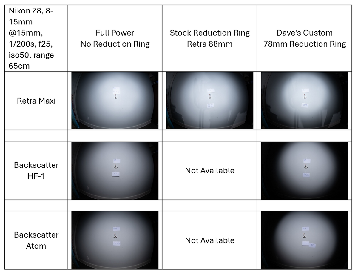

Coverage delivered with Reduction Rings
Summary Notes:
  • Retra’s stock reduction ring is 88mm wide.
  • The Retra 88mm reduction ring provides a more defined edge that is only slightly smaller than the naked strobe.
  • Backscatter does not currently provide any reduction rings for the HF-1 and Atom strobes.
  • I have made my own set of custom reduction rings for all three strobes with a consistent 78mm aperture. (Available for free on MakerWorld)
  • The 78mm reduction rings provide a sharp edge with about 90-100 deg width.
  • Additional 60mm and 38mm Macro & Super macro rings are available for all three strobes.
  • The Retra reduction ring does not allow for the use of a warming filter.
  • My custom HF-1 reduction ring fits over the 4500k flat filter allowing the use of both modifiers at once.
Summary Notes:
Dear Dave, according to what you wrote above the Maxi cannot be the brightest.
If the delta at +1 gap is that close, than it is very logic that the Backscatter HF-1 Hybrid Flash will outperform the Retra Maxi Strobe when set at +2 Level.
Could you please clarify why the HF-1 was not put at +2 power level when you compared it ?
Thank you very much for this interesting comparison...👍
Concerning the bursts at 3fps, could one say that, at reduced, but comparable output levels, the performance of the three strobes is good and pretty similar?
I mean that the Maxi at 1/4 power and both HF-1 and Atom at 1/2 power deliver similar output and provide stable exposure during the 3fps burst for 10 exposures...
(when higher output is selected, all three strobes become unreliable (reduced output with Retra, dropouts with Backscatter)
"The fall-off of light is similar across all three strobes at around 1 f-stop 50 degrees from center.
  1. The Maxi has the greatest fall off at 1.22 f-stop reduction from center. The HF-1 @ 11 has the least at 0.92 f-stop reduction."
#1.: Would this fall-off be similar when the (dome)diffusers are attached, or would it become smaller (towards more even spread of light)?
#2.: Is it possible to say how this compares to the very best strobes, with repect to even spread of light?
