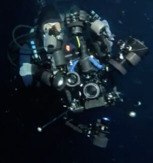

Yes, I use the dual flip all the time now, with the AOI +6 and the CMC-1 - had to balance it with a buoyancy block, but it's fine. On the LX10 the main issue is that the port is so short the lens can bump into the housing, and do get in the way of the lights for macro, but it's manageable. It shouldn't be an issue with a longer port. Streamlining and macro don't go together 😁
my "compact" LX10 rig in BW neutral buoyancy configuration - some people have nicknamed it the Nostromo...

DOOMSDAY DEVICE!!!

That kit is not for the faint of heart!
