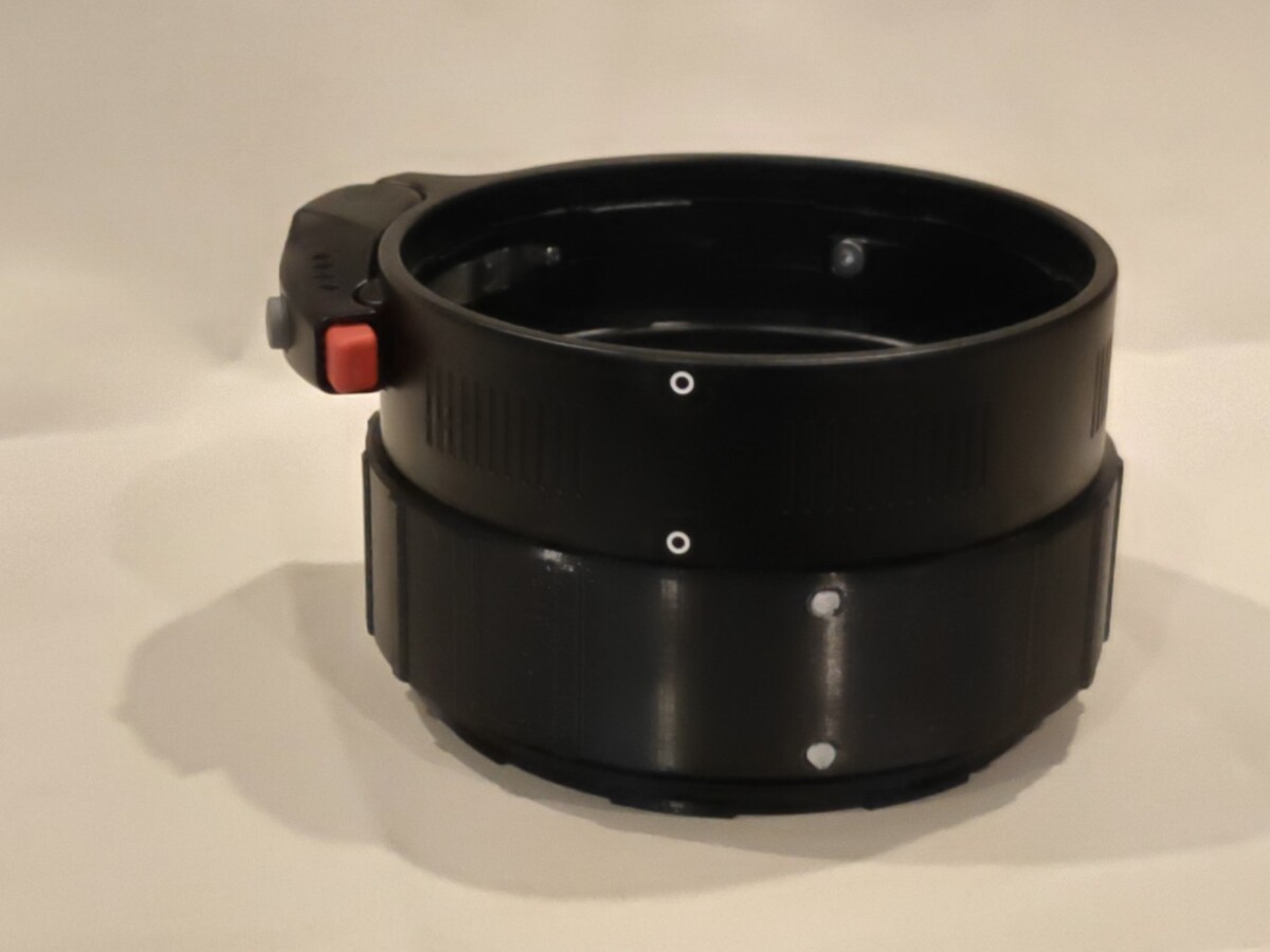

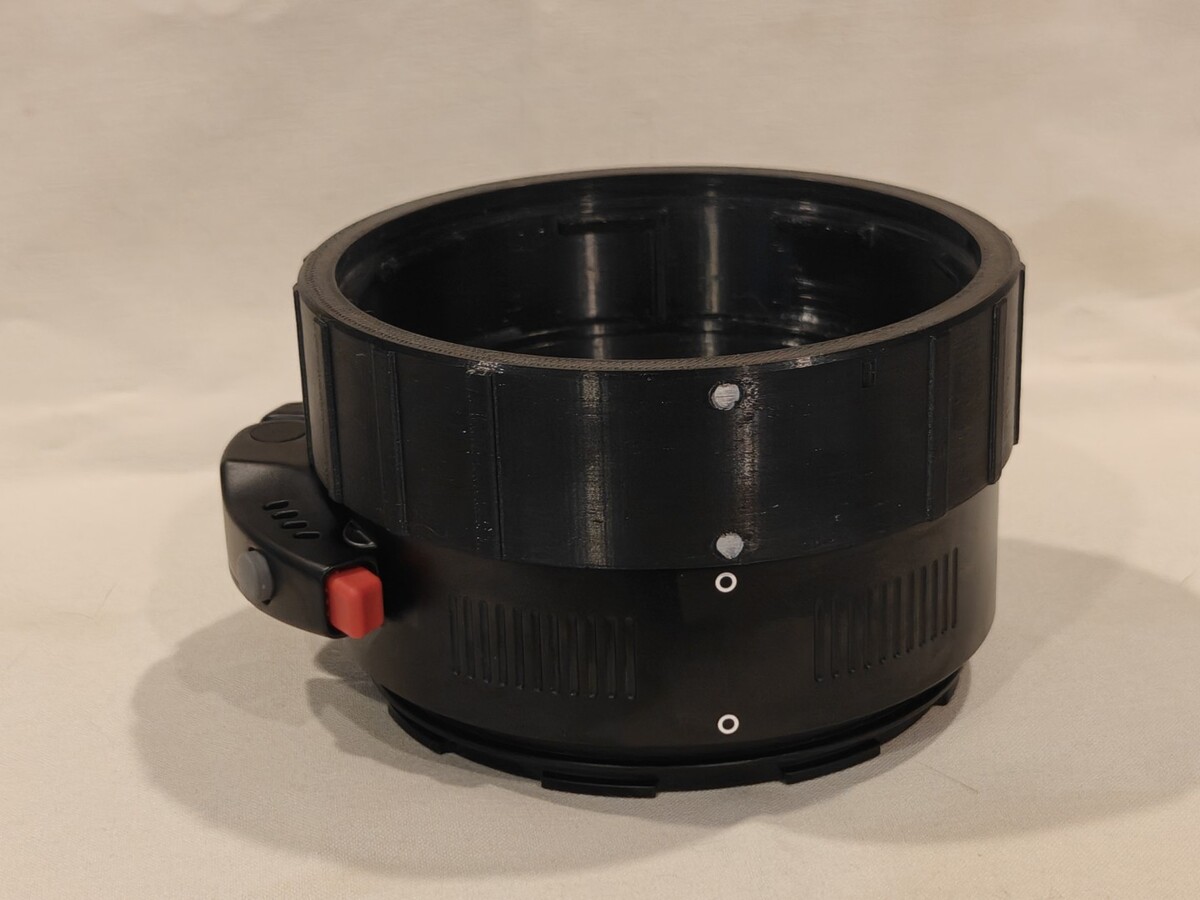

I finally was able to borrow an n100 extension ring to get measurements and make prototypes of Nauticam n100 compatible parts. I can print out any size ring from 20mm on up.
It all fits perfectly, but still needs to be tested in a vacuum sealed housing followed by a test dive. The basic design pattern and pressure resistance is well tested in the n120 versions I've been using for months.
The person I borrowed the ring from is out of town for a few weeks, and I don't have a housing to test it,
I need to find someone else to test it out. Any volunteers??

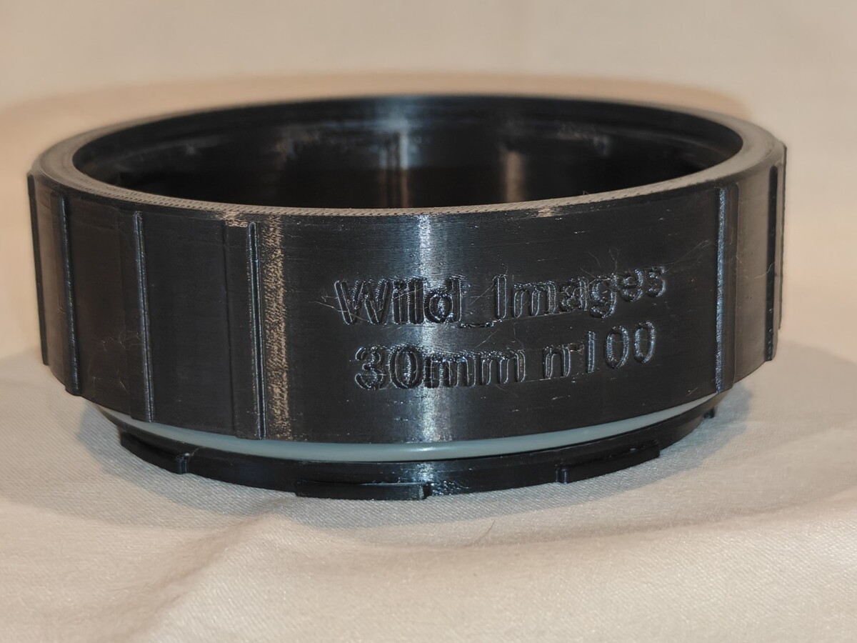

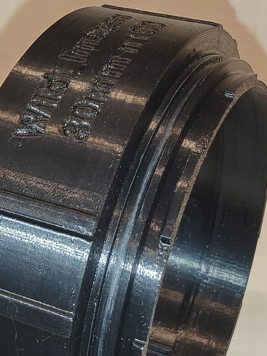

They work great. I've pressure tested and iterated the design and printing process until they are very robust. I have been using my n120 rings for months and many dozens of dives, and I have tested the n100 rings to even great depths than I can dive.
I did a price quote with a CNC vendor and it was around $200 for a single copy. Printing them myself is much less expensive and the reliability has been great. Heads up that it's not a simple print to replicate without really knowing what you are doing and dialing everything in just so.
PM if you are interested in any size n100 extension ring. I have not shared this particular design, sorry.
