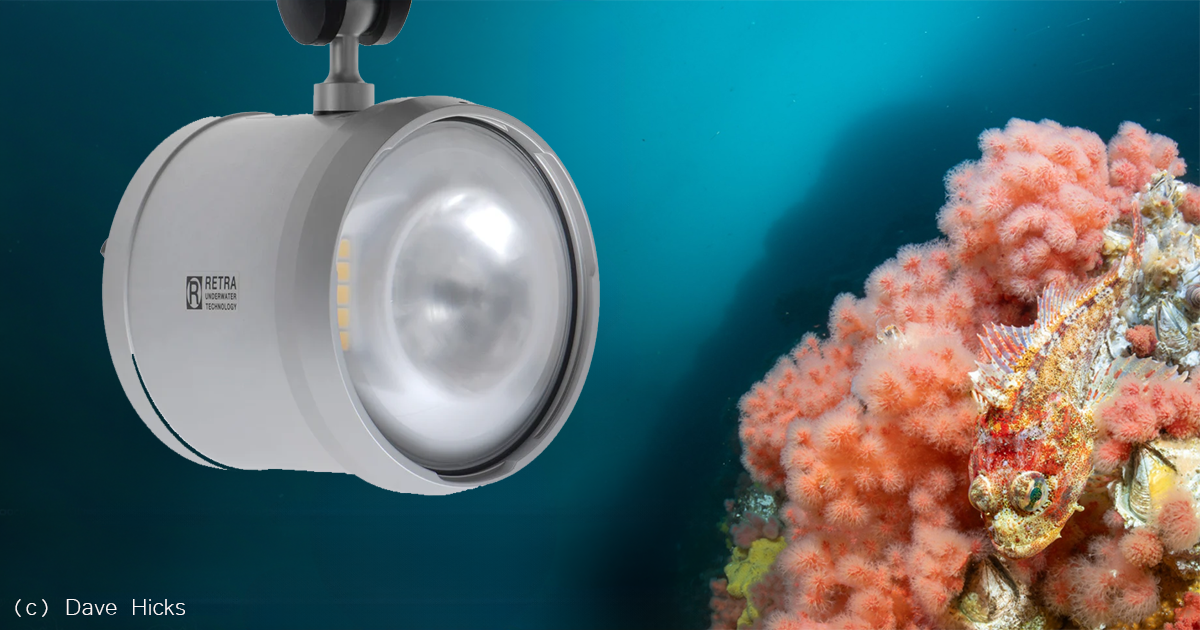

My review of the Retra Maxi strobe is now available at Inside Scuba as part of issue #66.
I started this review with some initial previews here on WaterPixels and really appreciate the input and ideas from everyone here. As I worked on this I decided that a long term review was the direction I wanted to take. Not just a few dives or a single trip, but experience with it over months and over 100 dives and very diverse environments. In the end I shot with the Maxi's from Dec 2025 to the end of June 2026 when I wrote the review in early July. Then a few weeks of editing and revision followed by a couple more getting it ready for publishing by Inside Scuba.
Thanks to Andy Deitsch & Byron Conroy for agreeing to publish the article!
Inside Scuba
No image preview
Long Term Review of the Retra Maxi Strobe
Dave Hicks tests the Retra Maxi strobe across 100+ dives in Raja Ampat and the Pacific Northwest, comparing it head-to-head with the Backscatter HF-1.

How are the ball mounts held on?
If you mean the ball mount on the Maxi, it's a 5mm hex nut through the ball.
I hadn't really looked at it previously. It comes attached as far as I know.

There is a single screw through the middle of the ball mount that goes into a sturdy thread in the strobe case. There is a plastic gasket to isolate (for corrosion) and an anti-rotation pin. Very solid mounting.
The mount is very solid. Oskar told me once you cannot over-tighten them either. Not that I’ve tried!
The ball mount does not come installed. They were in a separate bag with the grease and spares and an Allen key. My recommendation is to remove the ball mount for transport to conserve on space and to remove the ball mount after a dive trip so that trapped saltwater there will not seize the threads or cause corrosion. A little dab of silicone grease will help as an anti-seize. This is not a fault or defect nor a complaint, just normal maintenance on an expensive item you will want to enjoy for many years.
Edited by Nemrod
  • Author
Good to know. The review Maxi's didn't come in original packaging.
Sure, take them off if it saves space. I've never actually done that in about 20 years of traveling with strobes. I take mounts off of my camera housings very often as they significantly increases their space requirements.
