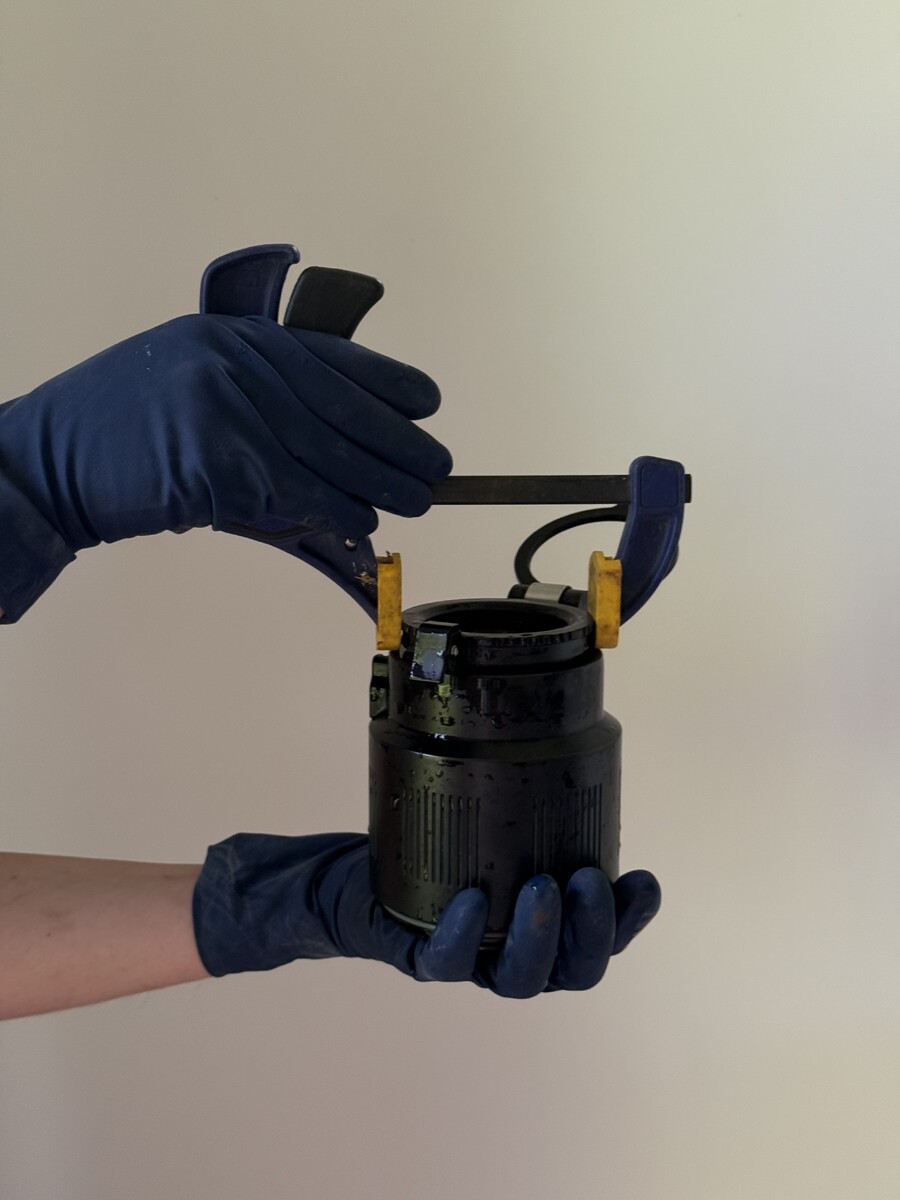

I had a stuck flip filter holder. Overnight soak in highly concentrated Salt Away, combined with a bucket of ice water and hot water still wasn't seemingly helping. Finally found this Irwin clamp in a drawer and that did the trick (I am guessing it was a combo of all three), but got it removed safely!
A strap wrench would have been virtually impossible to use on this filter holder, they can work on the actual lenses themselves though...

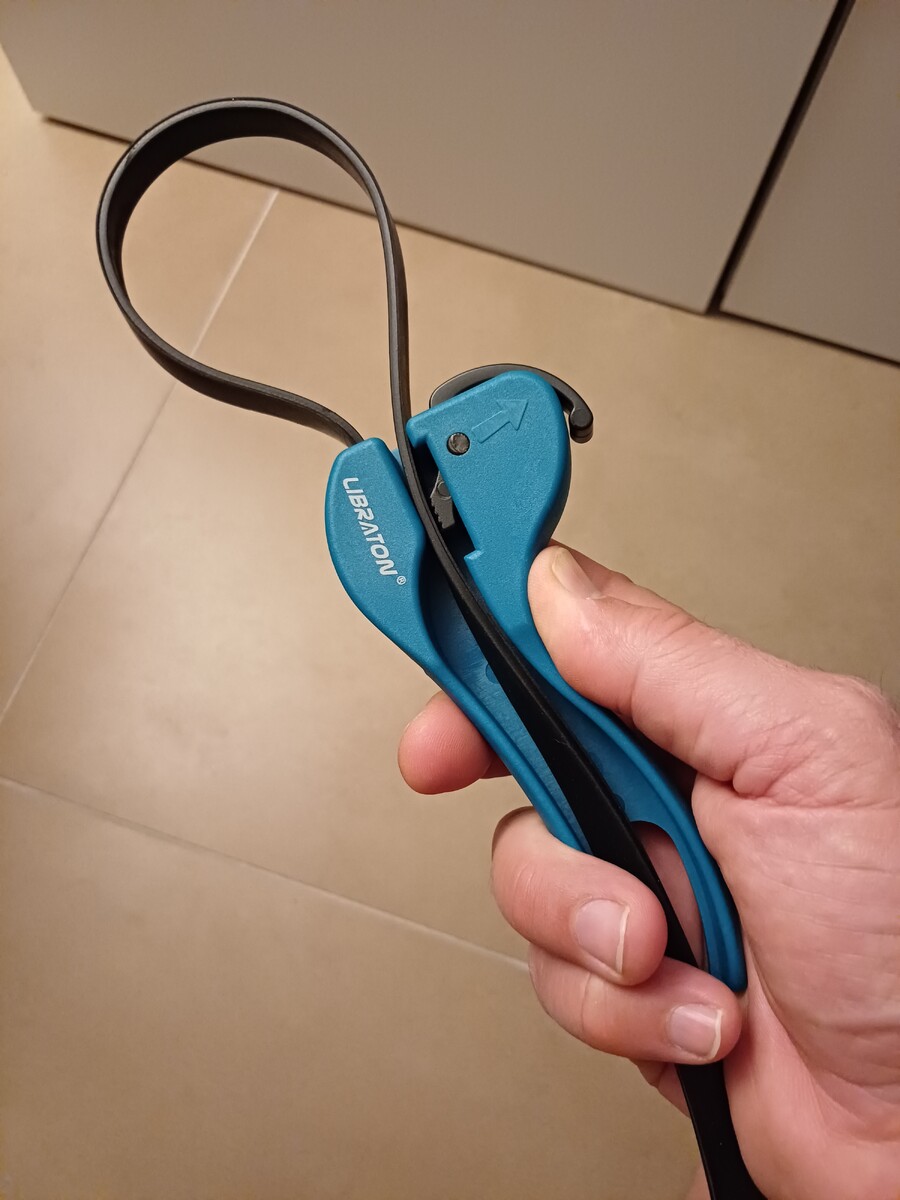

I had a related experience a few years ago from buying a secondhand housing with a threaded lens port that refused to come off. I bought a special strap wrench to try at first and used penetrating oil a few times as well. Then I tried the thermal trick by placing the housing in a chest freezer. Trouble with that was that it got covered in condensation when I removed it as I live in a rainy area (northern limit of rain forest that extends southward through BC to Washington state. Months later, during winter, we had a very cold spell, dry and cold, so the temperature was well below freezing outside. Finally that worked, after a few hours in the dry cold. Humidity was also low indoors so very little condensation.
Edited by Tom Kline
Too funny, I have the same exact strap wrench. In this case, I wasn't able to get it to grip well with the small surface area. The Irwin clamp happened to work easily and didn't damage the surface. Just wanted to give people a heads up of another potential tool to use. After breaking my last lens with the combination use of a vice clamp and induction stovetop; I figured I'de share something that worked this time around. But I agree, those strap wrenches are great!
Edited by insomniac
