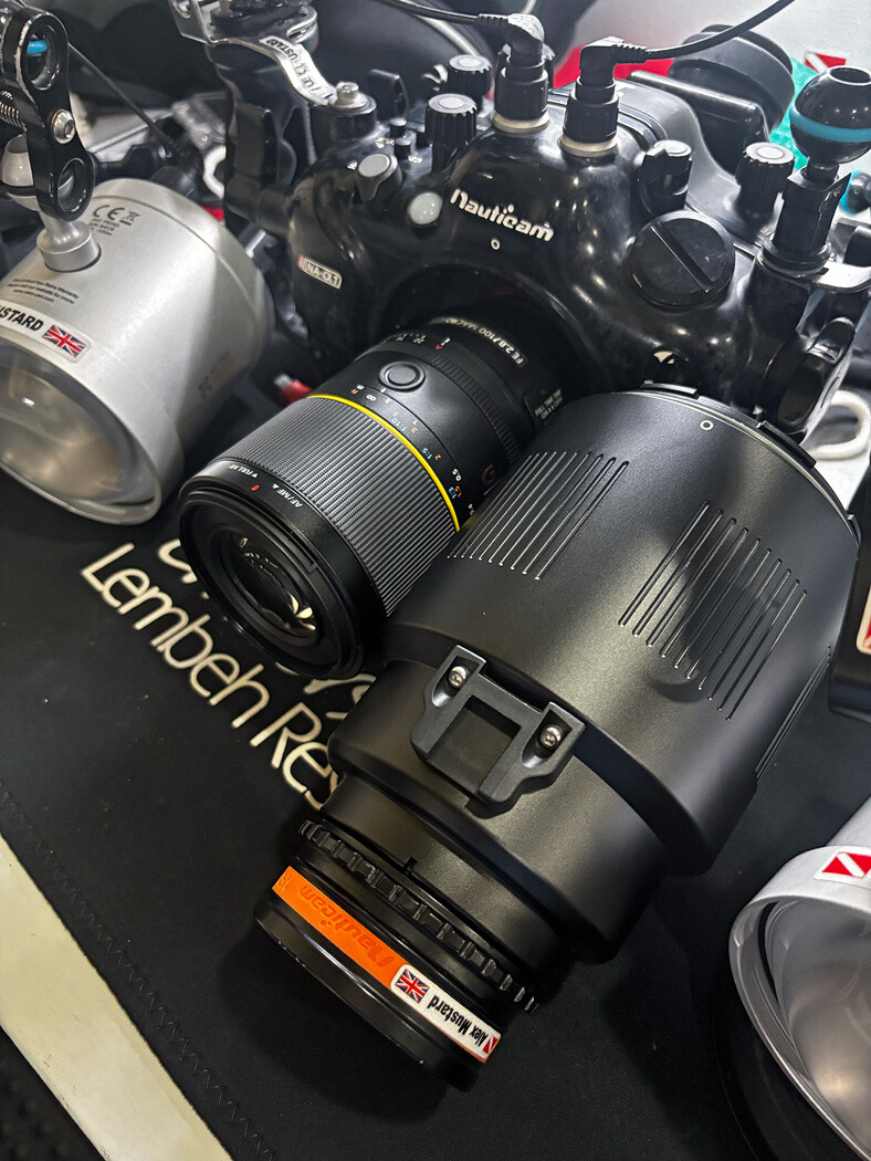

One thing I meant to say yesterday was to always be careful when lenses end up very close to the glass - I’ve seen a few times problems when the housing compresses underwater (more port sections - more o-rings - more compression), the port then pushes the lens and camera back in the housing enough that the push buttons on the back of the housing start activating.
Good advice, Alex. In fact, the shortest option is really tight (basically the space of a business card), so I’m a bit worried about it. Anyway, I also tried the 97mm + 20mm combo and it's fine — there’s no vignetting with the close-up lens (SMC-1) mounted on the flip. So this is probably the best option: fewer extension rings, less bulky setup... (until the proper port will be available)

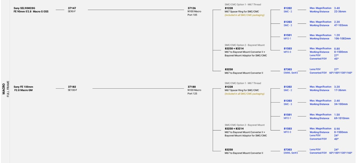

Nauticam has just updated its port chart for the new Sony 100mm Macro lens
I'm a little surprised by the magnification achieved with the SMCs compared to the 90mm lens.
I expected the magnification to be greater (as the 100mm has a magnification of 1.4), but according to their informations, the magnification is equivalent, or even lower than with the SMC2.

The magnification achieved by a diopter is related to the focal length of the macro lens used. With the same diopter a longer focal length lens will have greater magnification. The Sony 100mm has a longer focal length - at infinity focus, however internal focus macro lenses lose focal length as they focus closer and to get the 1.4x magnification the 100mm macro focuses significantly closer at max magnification. Working distance for the new lens is calculated at 92mm while the old 90mm macro had 129mm working distance. This is quite a reduction in working distance and probably indicates a significantly shorter focal length compared to the old lens when operating at minimum focus distance, so the diopter gives less magnification.
You will see the working distance for SMC-3 at max magnification has reduced from 22 to 17mm so there is no room to reduce working distance any further. Also see that the magnification for the MFO-1 has increased from1.2x to 1.5x on the new 100mm lens. I believe this data is from Nauticam doing tests on the lens with their recommended ports and diopters.

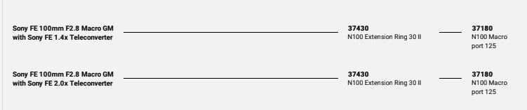

What caught my eye more, and most likely a typo i guess, is that they list both 1.4x and 2x to use 30mm extension.
When comparing the working distances between Sony 90mm and 100mm macro lenses it is required to compare working distances at comparable magnifications (e.g. 1:1) in order to compare the effect of close focussing on focal length.
As you write, the working distance of the 100mm lens is shorter compared to the 90mm lens, but this is at magnification 1.4:1 instead of 1:1. Only when the working distance of the 100mm lens at 1:1 is shorter compared to the 90mm lens, focal length of the 100mm lens is in fact smaller at 1:1 magnification...
It seems that in practice the way to increase magnification beyond 1.4x with the new macro lens is to use the TCs rather than diopters (Moreover, the working distances at high magnifications become sweet as sugar with TCs 😋)...
... or it is perhaps confirmation that extra 10mm in space between port glass and the lens won't matter (1.4x is 17.4mm while 2x is 27.2mm added length to the lens). Which means that using old port 105 with 30mm port extension might be feasible for new 100mm macro (?)

Marelux offering for the new Sony FE 100mm F/2.8 Macro will be flat port 112 (part 31307) on the Sony port chart. The current sony 90mm macro port is 97 so could be combined with the standard 15mm port extension to get to 112. All flat ports have the 67mm filter threads.

Perhaps I was not clear, Marelux has added a 112mm flat macro port to the Sony port chart for the new Sony 100 macro.
Nauticam has added a 125mm macro port to the Sony port chart for the Sony 100mm macro.
Neither Marelux nor Nauticam has made any additional recommendations.
It appears that if Nauticam made an N100 20mm extension and it was added to the current Sony 90mm 105 port it would be 125mm.
Also if the Marelux 15mm port extension were added to the 97mm 90mm macro port it would also be the recommended 112mm's.
I have no idea how close to the port glass the lens 100 will sit with each port. The Nauticam recommended 30 II extension for both the 1.4X and 2X teleconverters seems odd since the 2X is about 2/2.5 times the length of the 1.4X. My guess is that about 30mm of extension seems correct for 2X and more like 15mm would be good for 1,4X.
