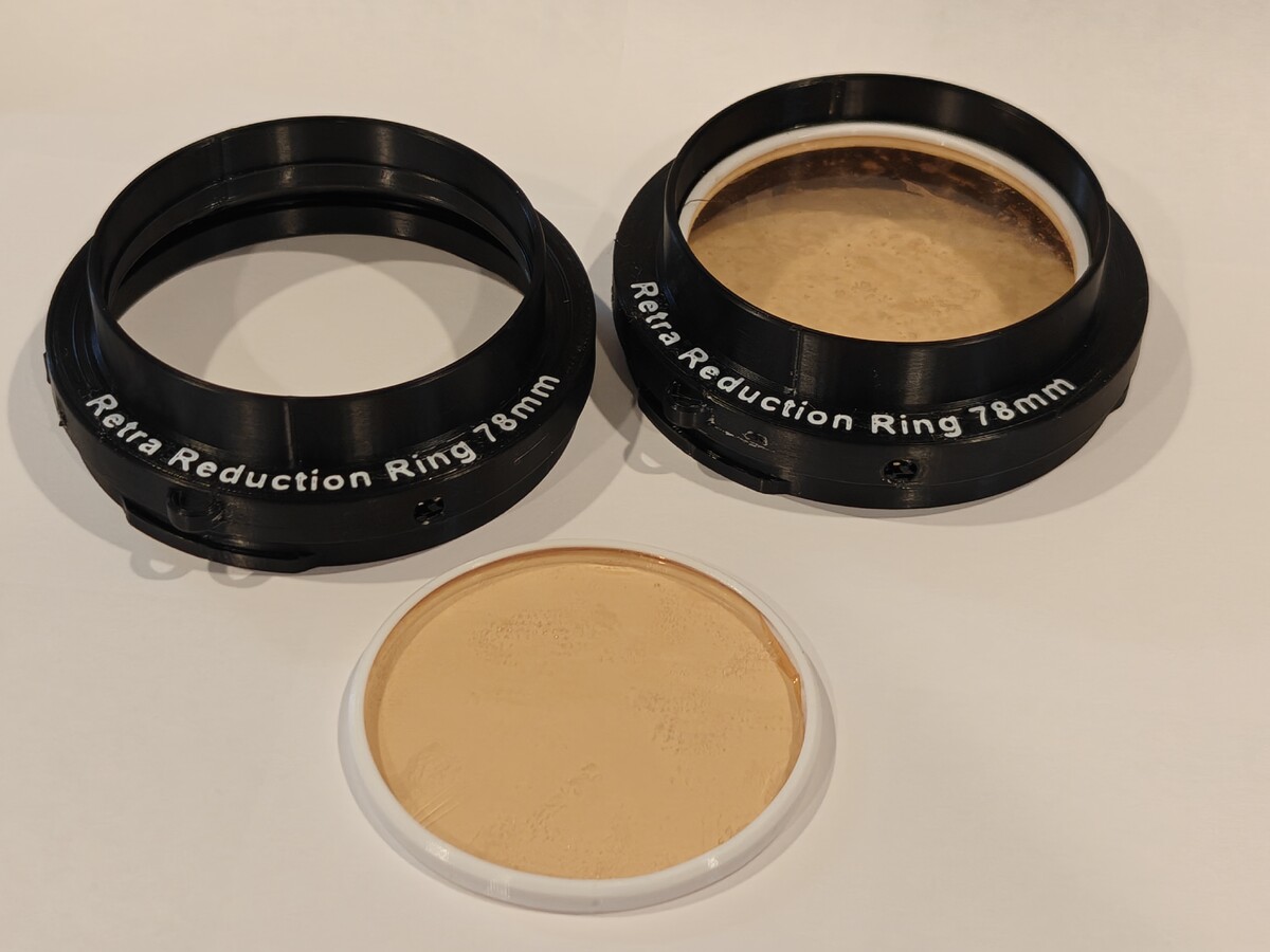

Custom Reduction Ring and filter:

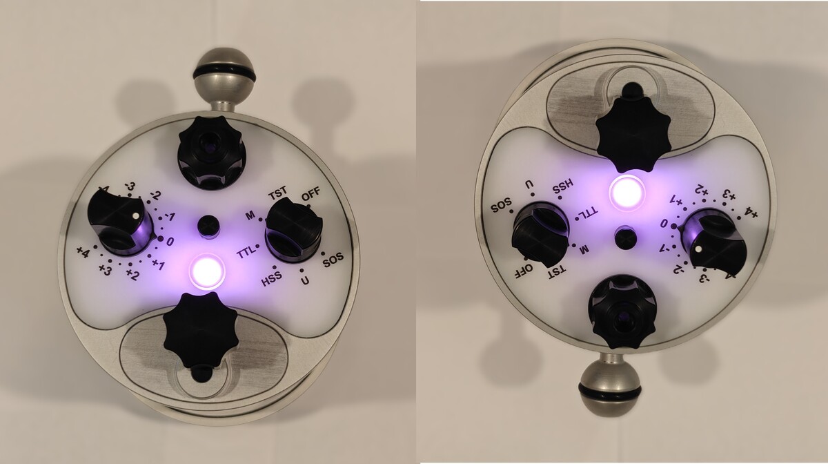

Retra Maxi Control Ergonomics:
I'll add one note here on the Retra ergonomics. The responsiveness and precision of the Retra Maxi controls are superb. Better than the Backscatter strobes for sure. The HF-1 power level knob is a crime against cold water divers. The Atom is better in that it's not simple round knob but a flat paddle, allowing your fingers to feel the position. However, it is smaller than I would like.
While the Retra Maxi control precision is excellent, I don't like that the Mode Switch and Power Level look identical to each other. The power level is longer, but I found it hard to discern which was which. This is exacerbated when the strobes are in different orientations, resulting in mirrored positions. As seen below. I often shoot with one strobe up and one out on long arms. I can't see the backs of the strobes when in an inward position and my fingers have to do the all the work. Both control knobs fell the same resulting in mistakes that screw up settings.

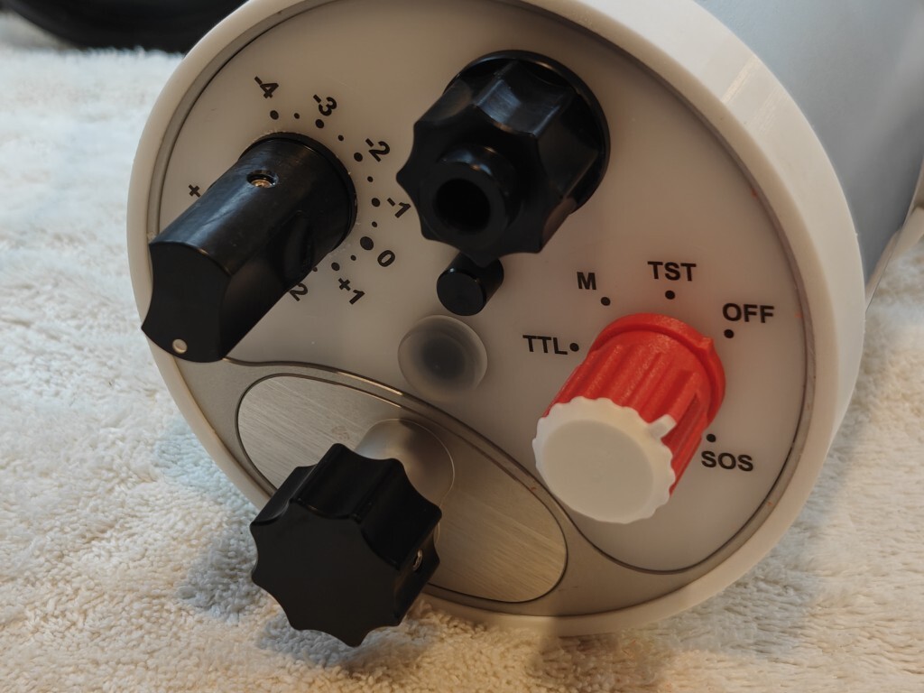

I love to customize the gear I use, so I addressed this with a custom made Retra Maxi mode switch knob. I find this design works a lot better for my style of shooting. It also fixes another issue with the Retra Knobs - salt deposits. The Retra knobs are completely flush to the back of the strobe and they have a internal voids that retain water. Even after a long soak and air blow dry, I will find salt encrusting the base of the knobs a day or two later. My design is essentially solid and leaves about a 1mm gap from the base, allowing the trapped salt water to be flushed out. I will probably make a custom Power Level knob that looks identical to the stock knob but leaves a gap to allow proper flushing of the salt deposits.
(If you look closely, you can see salt around the base of Retra's power level knob even after I wiped most of it off)

Firstly thanks to Dave and Kiliii for the comprehensive reviews.
On the question of salt, it seems to me it is very difficult to get rid of this salt in crevices etc. Just soaking won't do it, there's very little driving force to exchange fresh and salt water. On my previous Z240 strobes I would find salt crystals between in the space between the o-ring and the edge of the cap. Capillary forces hold the water in there and even after a 2hour soak or longer there's still salt there. If I change the batteries I can taste it, if I don't salt crystals eventually form. This is a problem on any small crevice, the gap between the two halves of the housing, buttons and control knobs, below caps like vacuum caps etc.
At least with housing buttons you can press the button a few times to get salt water to leave, you can turn the knobs - but this doesn't do a lot I don't think. I have taken to blasting each control with with a blower bulb ( I use a Giotto rocket blower, surprisingly effective) , you can get a squirt of water out on all the housing buttons. I have Retra pure strobes, I aim the the nozzle at the base of each knob and the light button and blast till no more water comes out. I've just ordered a rechargeable air duster which I'll try out after next dive.

Likely won't work if your strobe is like this one. Zero gap under the knob and i use a powerful electric blower after a some hours in the sink. The knob ought to have a little space to drain, even if a small hole or slot at the bottom. There is a considerable hollow under the knob that retains a CC or two of water.
Hi Dave,
would you share the 3D/CAD files of the knobs. I also sometimes mix up the power and mode knob due to almost same design (only length is differnt). I was thinking to design a clip-on knop. But if your design solves also the "salt problem"👍😃. To be honest, I hadn't figured out the salt problem until today. Will later remove a knop on my strobe to get an idea how much salt stuck there.
Br Markus
