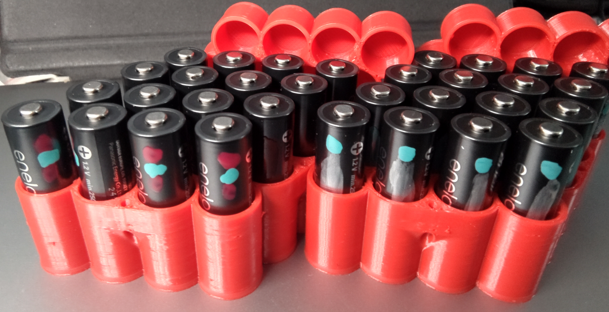

I will now order 32 new AA Eneloop Pro.. to replace the 32 "lost" last week. 😭
