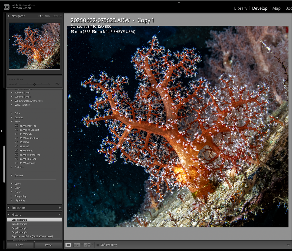

I also think that - surprisingly to me - at the long end the WACP-C/28-60 was a tad sharper than 8-15/TC. (While the same 28-60 paired with WWL-1B was really disappointing).
But all in all each use case is different and I can totally see that the desire for extreme - and flexible - wide angle would present this 8-15/TC as the best option.

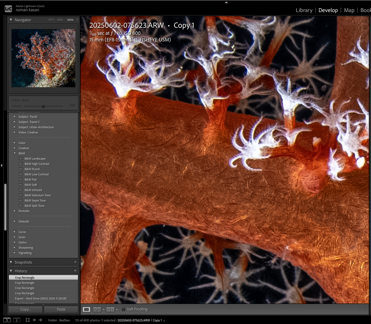

yeah, 8-15 without TC is a beauty... sharpness and microcontrast are TOP!
