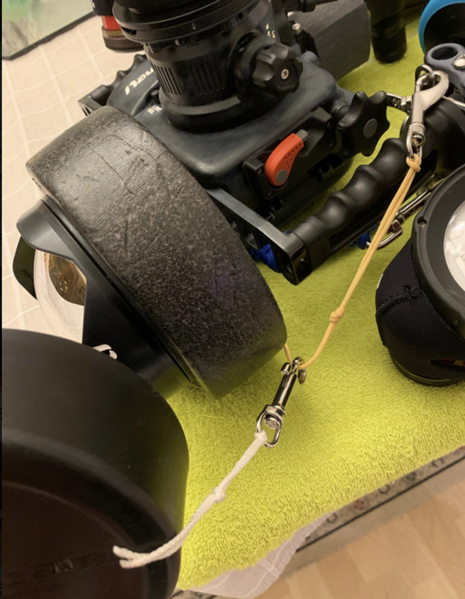

I always keep my lenses covered entering and exiting. My WWL hard cover is drilled for a piece of cave line and bolt snap. The cover is always attached to the lens safety line or clipped off to my scooter ring when in use. My CMC lenses and dome port have neoprene covers which likewise have a small bolt snap for me to clip them off to the camera when on the lens or to my scooter ring in use.
Ikelite has several full neoprene covers with a zip drawstring that are easier to slip on than the bikini type. I use one of those on my 4.33 inch Nauticam dome. And, of course, a bolt snap.

I have a significant divot in my Sea&Sea 12mm from a shore exit because I couldn't get the neoprene "bikini" cover on. I've been trying to figure out a better design since.
I believe Dave Hicks has 3D printed designs in TPU.
Edited by Grantmac
Yes, i made a TPU rubber design that is much easier to install underwater than neoprene and it rinses and cleans better.
Currently available Dome Ports are:• AOI DLP 06• Nauticam 8.5 inch • Nauticam 140mm• Nauticam 180mm• Sea & Sea 12mm • Zen DP 100• Zen DP 170
https://makerworld.com/models/2391039
Edited by Dave_Hicks
Hmmmm, maybe the OP needs a Dave Hicks cover for his rare S&S lens! Maybe I do too for my Nauticam dome ;).
Edited by Nemrod
I use the neoprene bag that came with the MFO3 to protect mine during shore entries. Cinch down the cord on the cloure to keep it on. Take it off in the water and clip it off and reapply during the safety stop. Just don't let go of it as it will float away. An alternative might be a beer cooler used to keep bottled beer cold while drinking, probably widely available. You might find one around the right size.
The advantage for me is it keeps the lens wet till I can soak it in fresh water after the dive. You could probably do something similar for your macro port.

I put together a simple DIY cover for my Nauticam CMC‑2 using a trimmed 70 mm vinyl end cap. Inside the cap, I wove bungee to form four small retention tabs that snap under the lens’ top ledge, giving it a secure, positive hold instead of relying on friction. It pops on cleanly, stays put during entries/exits, and the parking loop on the hinge gives me a backup in case it comes off before I can clip it off underwater. Surprisingly solid for a no‑3D‑printer solution.
