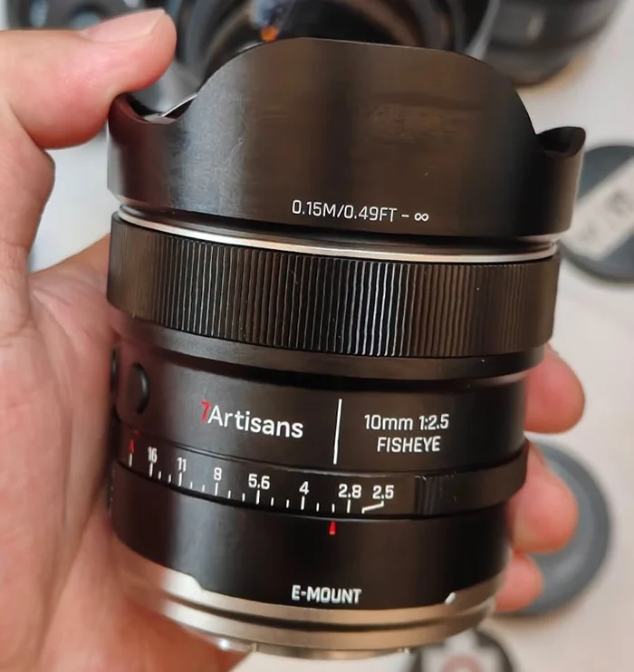

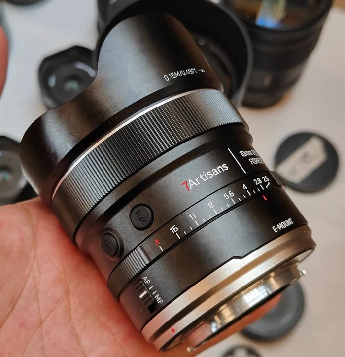

    Additional specs on this new lens. Focal length: 10mm Maximum aperture: f/2.5 Lens type/format: Full-frame autofocus fisheye Angle of view: 185° Optical construction: 11 elements in 8 groups (inc
  • Phil Rudin
    Phil Rudin
    Today 7Artisans has announced on its Facebook site that the AF 10mm F/2.5 MAX fisheye will be released on August 27/GMT+8 for $449.00USD. The post does not indicate if the lens will only be sold on th
