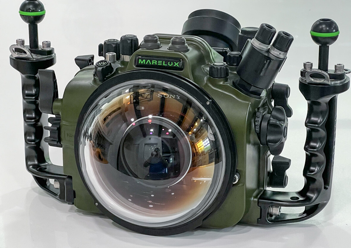

For Marelux system users the Sony FE 8-14mm zoom gear will be #51117. Used with a 20mm extension for 140, 210 and 230mm dome ports.
The Marelux 140mm port already has the removable bayonetting sunshade introduced four years ago at DEMA with a retail price of $1180.00 in the US.
Very snug!
That is going to require a clever port cap solution or that glass is going have a short shelf life
13 minutes ago, Dave_Hicks said:
Very snug!
As you may or may not know the sunshade needs to be removed from ANY port to use the 8mm end of the lens. The photo shows the shade removed. The photo below shows how I take the system into the water. In the water cover is removed and slipped over my arm. If I want to shoot the 8mm circular fisheye end of the lens I then remove the shade.

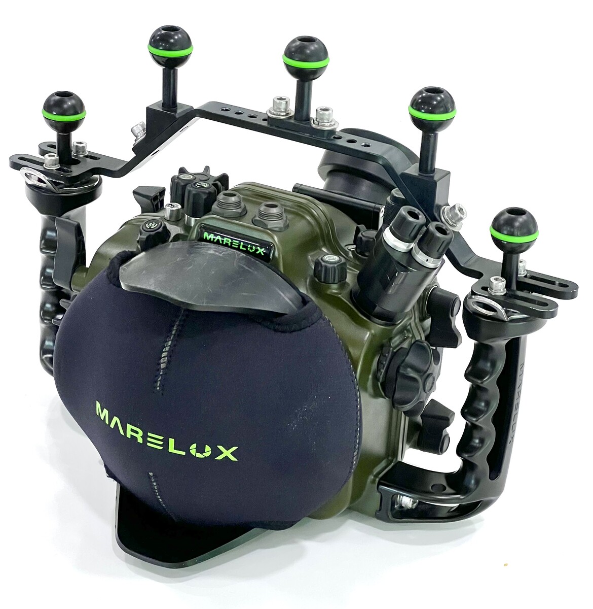

I had the new Sony FE 8-14mm F/3.5 G in the pool today and I will add some on my thoughts.
As I am sure most of you know the lens is light and small for a 8-14mm fisheye 314g compared to 476g for the Canon 7-14mm F/2.8 to 3.5 L and 504g for the 7Artisans 10mm F/2.5 MAX. Canon is the widest at 7mm with an AOV of 190 degrees while the 7Artisans is 185 degrees and the Sony is 180 degrees. All focus to 15cm and all can be used in a 140mm dome port. Price ranges from Canon at US $1899.00     Sony at US $1598.00 and 7Artisans at US $449.00. I included the 7Artisans lens because between the three it is by far the best value being equal to or in some cases exceeding the Sony at 14mm. I will not comment on the IQ of the Canon because I have never tested that lens.
For the attached images I used the Sony A7R IV camera which gives 66.5 MP files and 28.4 MP files in APS-C mode according to the Lightroom meta data. The Sony can zoom from 14 to 9.5mm while in APS-C before starting to vignette. At 8mm the APS-C crop vignettes in all four corners and cuts off the top and bottom of the full circle.
I tested the lens using a Marelux A7RVI housing, MX 140mm dome which has a removable bayoneting shade and a 20mm extension, this is the same combo I use with the 7Artisans 10mm. I also used two Marelux Apollo-S strobes attached directly to the housing grips. All of the images are full frame with no crop. I have not yet received the zoom gear for the lens but hope to have it for DEMA. For these tests I locked the lens at 14mm and then at 8mm which to me are the most useful ends of the lens. I included one APS-C shot with the vignetting at 8mm.
