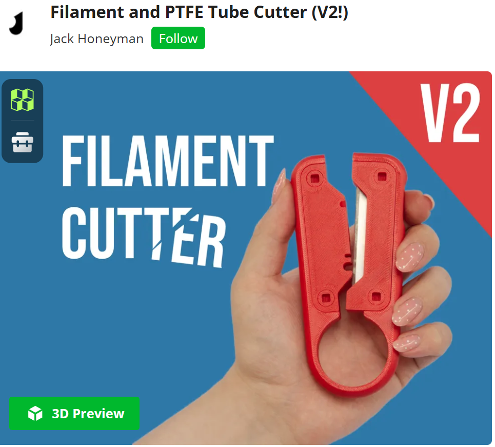

With the right tool of course - no scissors!
You don't need any special tools to cut fiber. I just use a >fresh< sharp utility cutter blade. Put the cable on a block of wood, lay the blade over the cut point, tap it with a small hammer to make a fast clean cut. Works perfectly every time.

Wow, someone found a way to charge $50 for a box cutter blade that sells in bulk for $5 per 100 count. :) I am sure that sort of precise alignment is important in some networking applications, but it's way overkill for this purpose.

I didn't say special, I said right - and scissors are the wrong tool, I recall someone saying they used scissors and had problems with their cables.

When I made my first batch - which led to the original article - I used scissors. The cables worked perfectly in Manual with my Retra strobes. But not in TTL (which I rarely use). It was a conversation with Oskar at Retra that highlighted that scissor cuts were the issue. I recut using a box cutter (aka Stanley knife) and the TTL issue was solved.
Our lab uses lots of fiber optics for a variety of medical applications. The cutting tool that I showed costs about $12 and gets you a very nice square cut. Modern strobes for the most part are pretty sensitive, but bad cuts often meant that the older S&S strobes were iffy.

I clicked the link. £36.80, €46. Is that a regular razor blade in the image of the cutter? I am guessing that a 1-off use of a fresh razor blade will give an even cleaner cut than a stanley blade.
Maybe one of our 3-d print experts could come up with design for printing such a block. I don't have a printer, but expect I could machine similar from aluminium or delrin. For individual use, it wouldn't need to last for 1000s of cuts.
Edit - seems there are plenty in the £10+/- range on ebay
