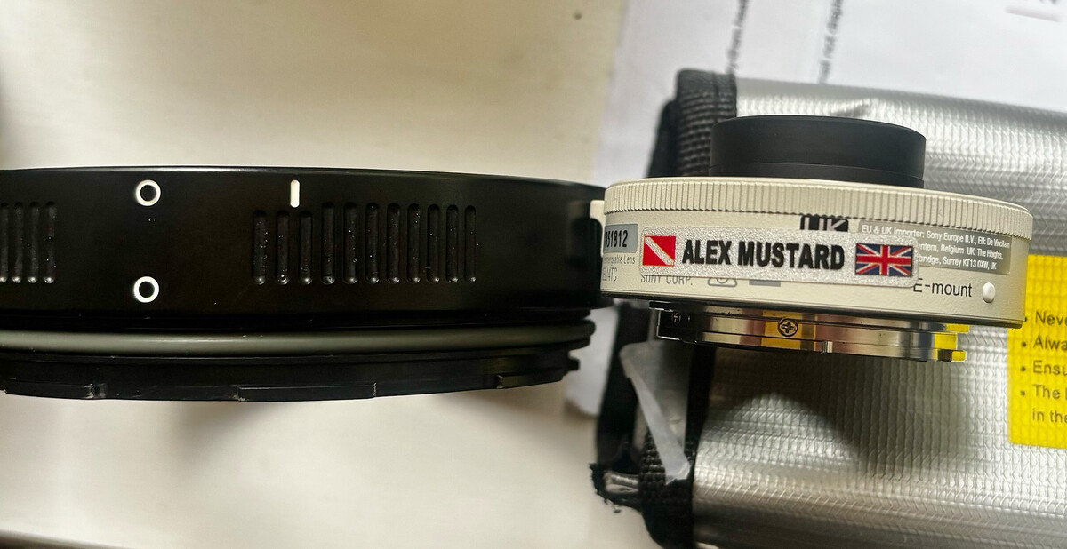

My guess is that we won’t see a N100 20mm extension from Nauticam. The ones I have are from early 2023, which Nauticam supplied for the FCP prototype testing (the port lock only worked with that port). And if they had wanted to make them commercially they could have already. But I know that the dealers complain when the product range that they have to stock becomes too large - which I think is why these were never made commercially.
I have a good range of shorter N100 port extensions (top-bottom: Nauticam 20mm, Saga 16mm, Saga 20mm and Nauticam 20mm) which I find very useful when experimenting with unusual lens set ups, adapters, teleconverters, internal close up lenses etc. Just sharing the photo to show that solutions are possible, but likely to be a custom build - and therefore I’d expect the new port to be the easiest choice for most. 16mm was the shortest port extension that Saga could make for me in N100 mount.
Alex

I think that the Sony 1.4x is about 18-19mm thick, so once mounted on the lens I think it will need a 20mm port extension (pictured). Nauticam do not currently sell at N100 20mm port extension, but it would make sense for them to do so. The one I have (not on sale) has an unusual port lock (I guess because of lack of space in such a small port extension) and the should make sure the new Sony 100mm port is compatible with this lock - if they go down the route of releasing this item.

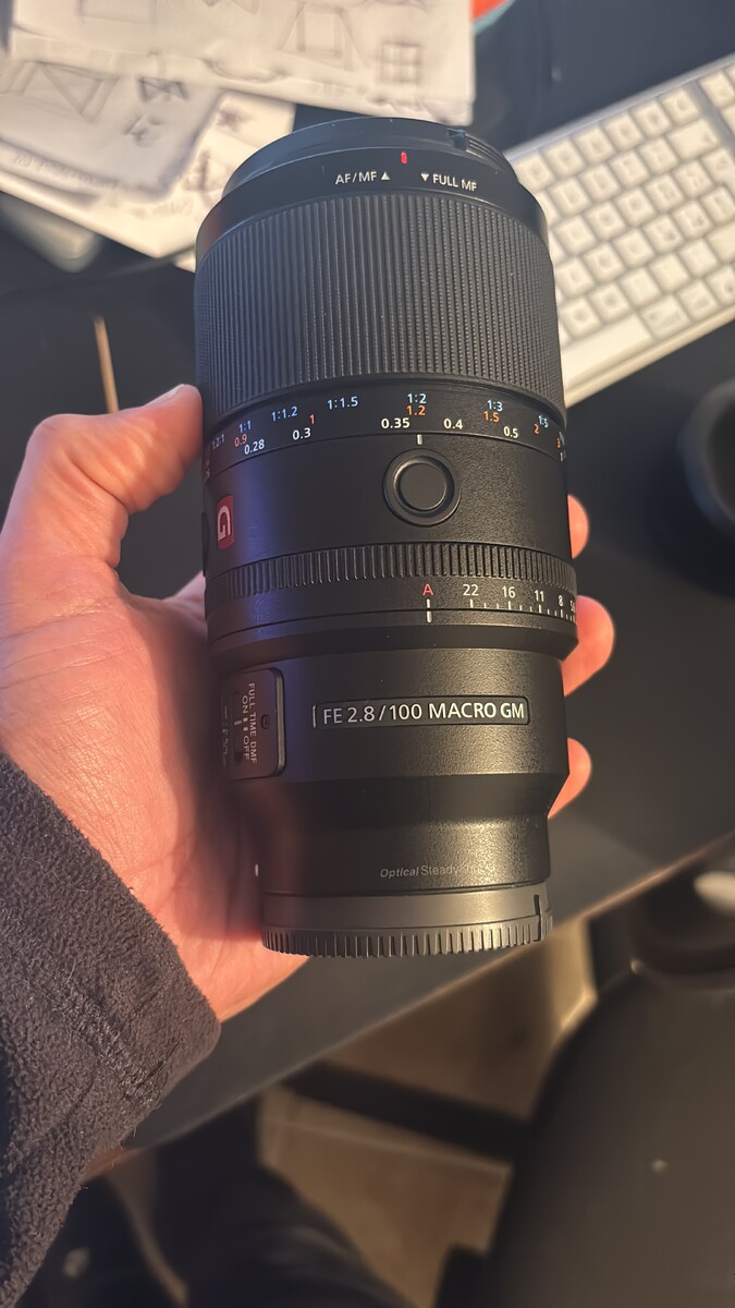

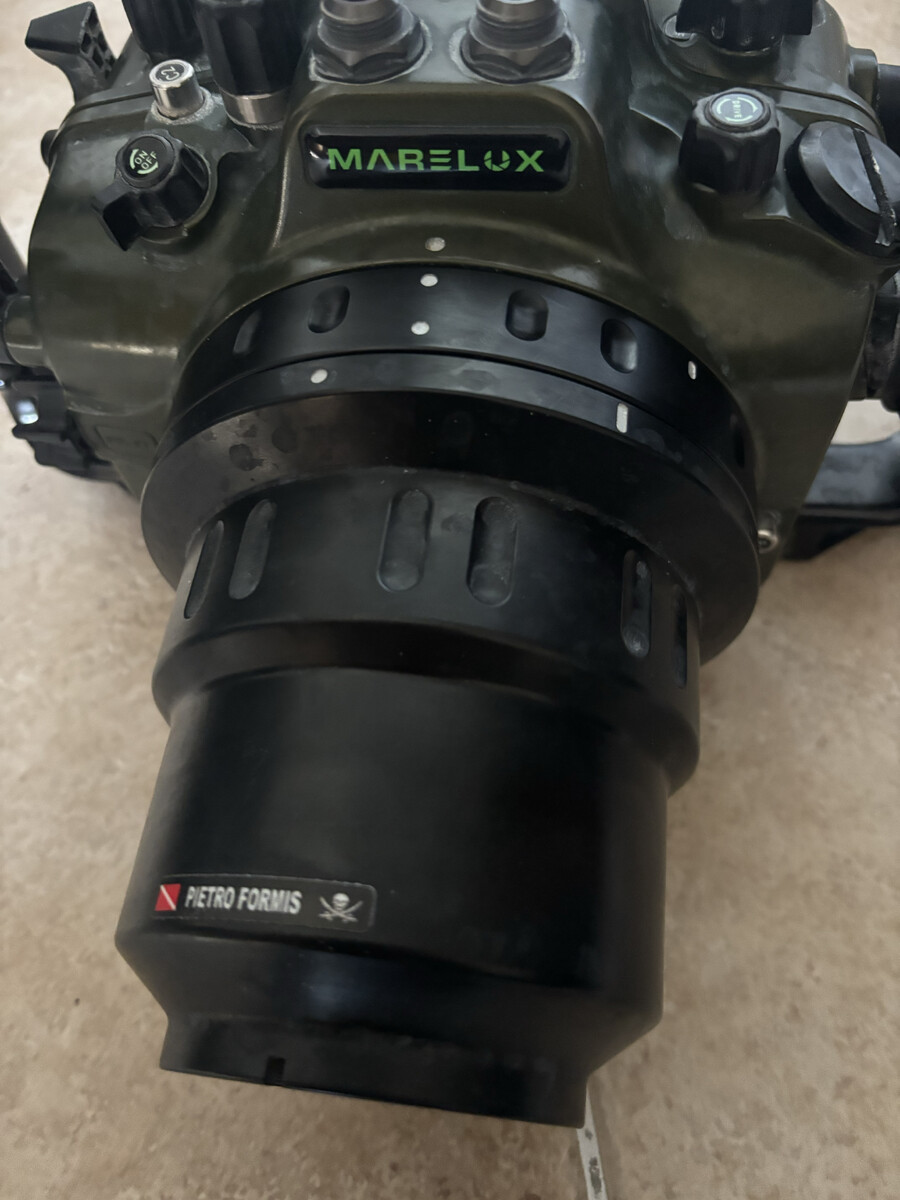

Got the lens from Sony Italy today for testing!
Using a 20 mm extension with the 90 mm port works — not perfectly, a bit too much space. (Marelux macro port is 97 + 20 extension = 117 mm;) I also tried the 32 macro port + 60 + 20 = 112 mm setup and is much closer to the glass…
First impressions on the lens: the autofocus is super fast… hope to test it underwater soon…
