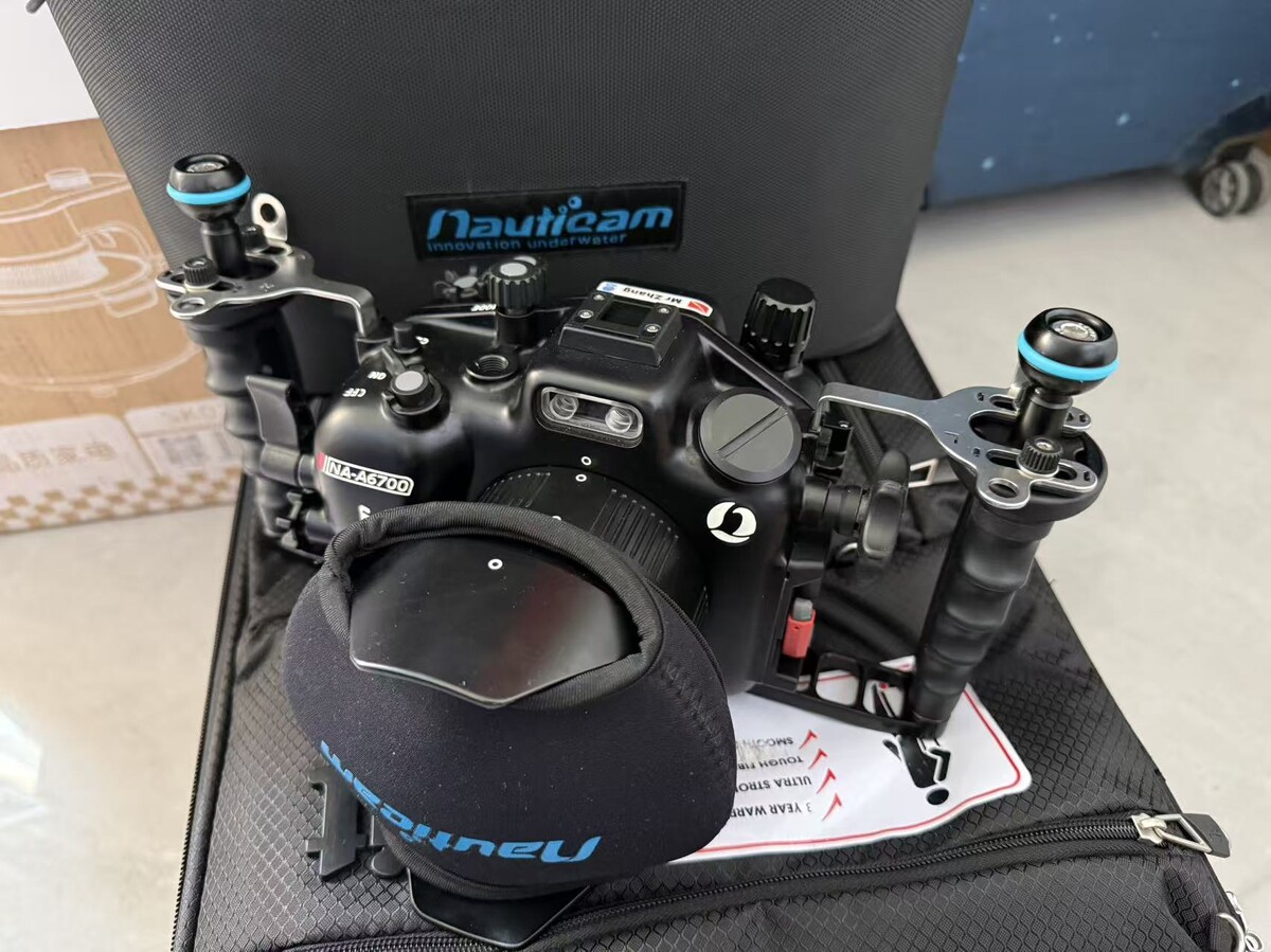

Just don't judge those images on lens sharpness etc; mistakes are likely on me...
Many thanks Simon. I downloaded a couple of the dolphin shots. Nice, but a bit soft in the corners. I'm guessing adding a short extension (10mm?) would help, but might introduce vignetting with the shade on (at 14mm). My guess based on what appears to be the Metabones V length of c. 26mm.
Or maybe extra 5mm is enough, in which case you could go 25mm adapter + 15mm ext...
If you feel like trying either of these, that would be great...
I've only got the 30 mm extension, unfortunately – hopefully someone will be able to start some proper pool testing in the near future!
