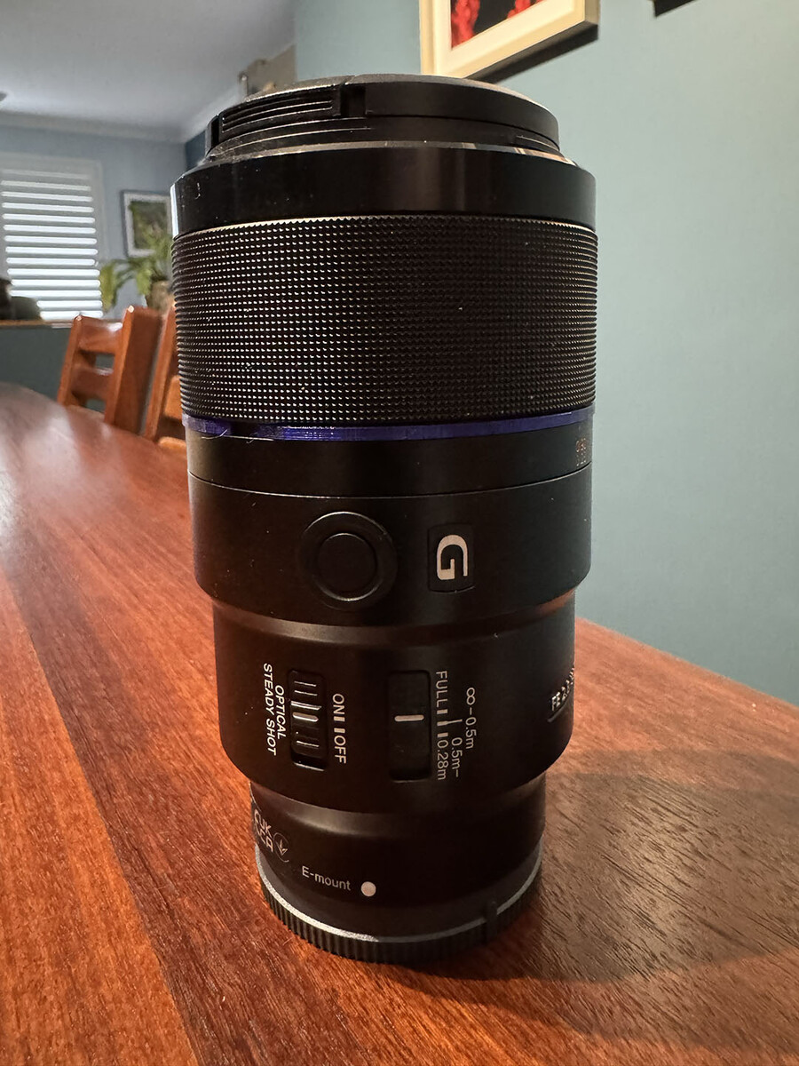

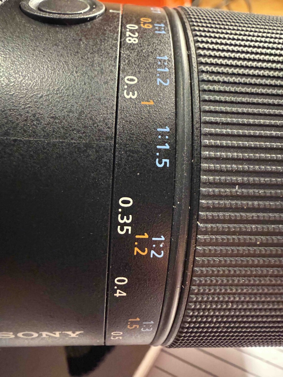

Oh, am I seeing a rubber band to prevent the AF/MF ring from switching back to MF inadvertently? Simple and brilliant idea, thanks. We've all been there, on a dive and feeling helpless with the ring that had moved back into MF.
O-ring from an old Inon strobe.
I designed and 3D printed a spacer for my Sony 90 macro and it works well, there a quite a few people who are happily using it now. Here's the STL for it below. I haven't got access to the Sony 100 macro but if someone can give me the following dimensions for the Sony 100 I can produce a design and upload the STL for it to Waterpixels for anyone who wants to download and print it:
If you don't have a suitable o-ring to hand, 2.4mm nitrile o-ring cord is readily and inexpensively available online and a length wedges in the gap neatly and securely. It doesn't need to be glued up into a complete ring and is easy to prise out if you want to release the MF clutch for use on land.
