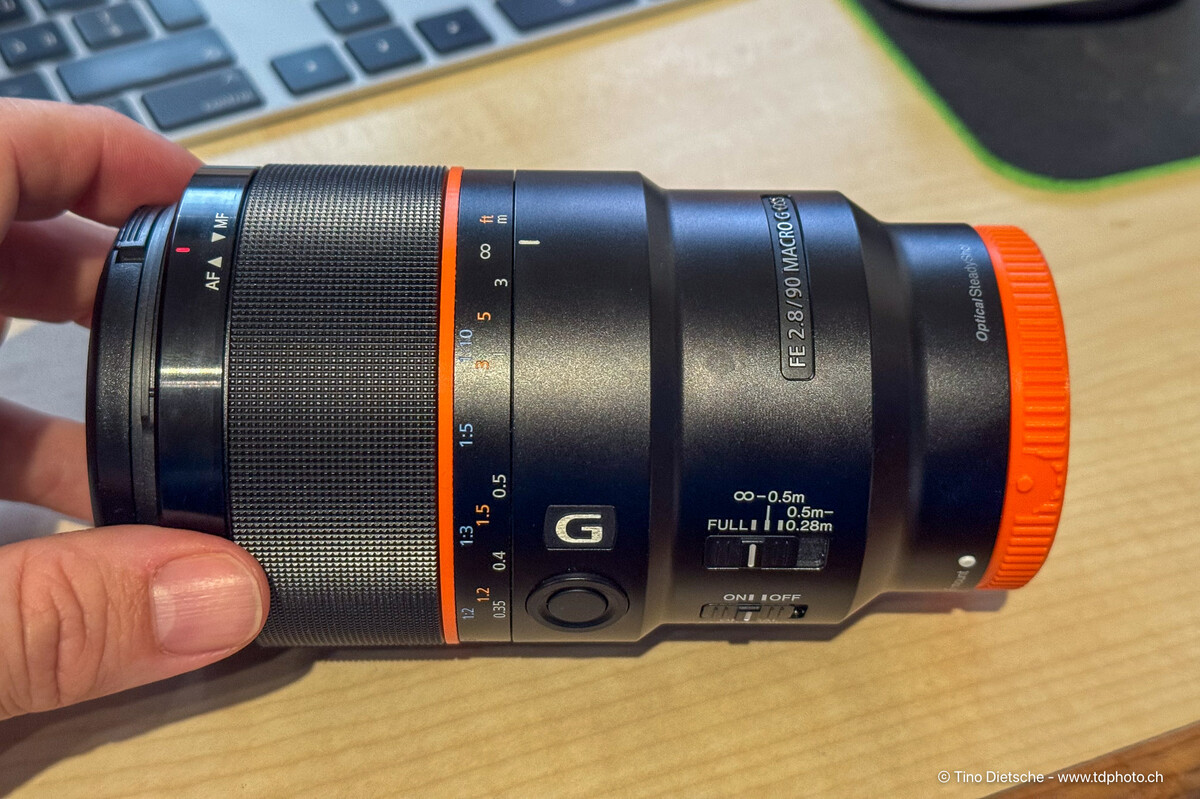

I designed and 3D printed a spacer for my Sony 90 macro and it works well, there a quite a few people who are happily using it now. Here's the STL for it below. I haven't got access to the Sony 100 macro but if someone can give me the following dimensions for the Sony 100 I can produce a design and upload the STL for it to Waterpixels for anyone who wants to download and print it:
  • Diameter of focus ring
  • Width of gap
  • Diameter at bottom of gap
Sony 90 Spacer.stl
Thank you so much for the file! I printed it out right away!
