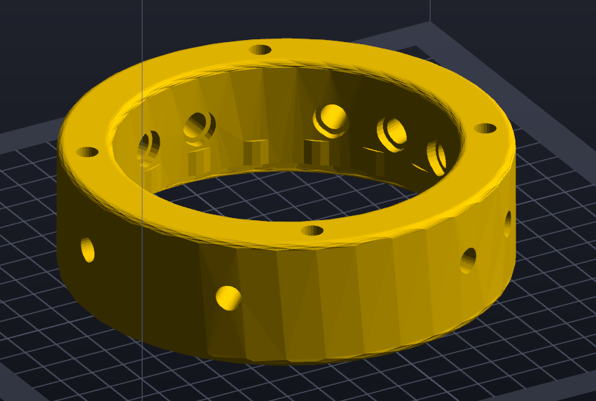

I took tim eto retrieve the 3D STL from my bloat for the Isotta H117 port

Hi everyone,
The project with my buoyancy bodies around the port is moving forward after the version for the 90mm Macro port has proven itself really well. I’ve now also designed a matching “ring” for the Sony 28–60mm port and will be testing it in the water soon. At the moment it’s filled with material from an insulation board, and I’m hoping to measure the actual buoyancy in the near future.
In the meantime, I’ve also managed to get hold of a sheet of high-density, closed-cell polyurethane foam. I still need to figure out the best way to work with it so the final result also looks decent. While I’m at it, I’m very open to suggestions for materials that work well as buoyancy elements in this kind of setup—especially if someone has already tested them.
If anyone would like to print their own “ring” for the Sony 90mm or 28–60mm port, feel free to get in touch with me for the STL files.
